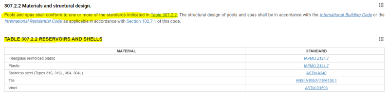

For anyone that is involved in code adoption and can fix it before you adopt it...Technically does not allow concrete or steel:
Concrete they fixed in 2024....Really solves the bonding problem/ questions when you can't use either of those though...
"in according with section 102.7.1. "
I wonder what this means if our state did not adopt chapter 1.
Reservoirs???
I would like to see a stainless steel pool or reservoir.
