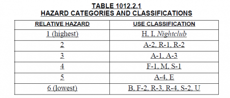

NC 2015 EBC requires sprinklers if changing occupancy to a higher hazard. The entire building would be required to be sprinklered unless the new A-2 is separated by fire barriers and horizontal assemblies. If that is the case the sprinklers would only be required in the new occupancy. So, if for example, the previous use was a B, and you are proposing an A, sprinklers are required. Then it is just a matter of whether there are existing fire separations or you want to add them to reduce the scope of sprinkler coverage. Chances are you are moving to a higher hazard category and will be required to provide sprinklers to some extent.
1012.2 Fire protection systems. Fire protection systems
shall be provided in accordance with Sections 1012.2.1 and
1012.2.2.
1012.2.1 Fire sprinkler system. Hazard categories in
regard to fire sprinkler requirements shall be in accordance
with Table 1012.2.1.
TABLE 1012.2.1
HAZARD CATEGORIES AND CLASSIFICATIONS
1012.2.1.1 Change to higher hazard category. When
a change of use is made to a higher hazard category as
shown in Table 1012.2.1, the building shall be provided
with an automatic fire suppression
system as required
by Section 903 of the North Carolina Building Code.
Exceptions: When an area of a building is changed
to a higher hazard category and the proposed use is
separated from the existing use(s) by assemblies that
meet the applicable fire rating in Table 508.4 of the
North Carolina Building Code, an automatic fire
suppression system as required above shall be
installed only in the area changed.
Unfortunately, this is what the inspector highlighted today is we are going from hazard of 6 to hazard of 2. This is what is triggering the sprinklers.
