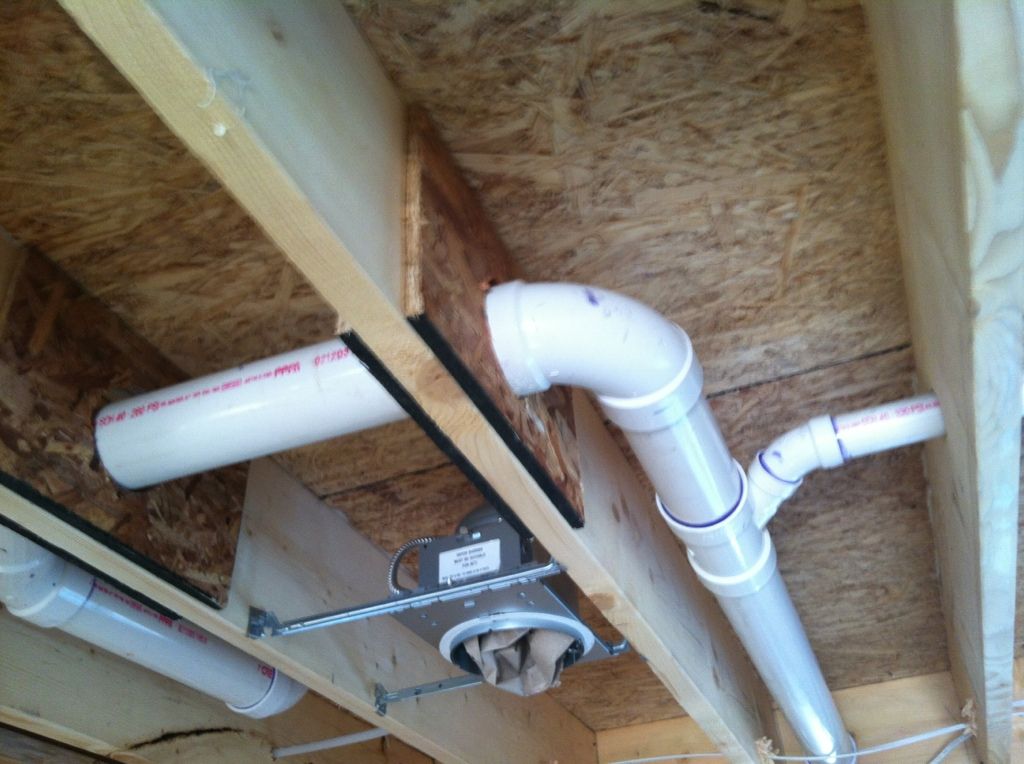

3" 90's

Does it really matter whether or not there is a clean out within 40'?
So where does it say that you can use a 90 for a 3" pipe if you have a clean out?
A cleanout is required for a change of direction greater than 45 degrees but no where is a horizontal 90 allowed for a 3" dwv
It looks like there's more than a third of the joist gone. And a little more needs to disappear so it's not choking the pipe. I guess the electrician got there first. Could the plumber go the other direction to miss the light?
45 degrees or is it 135 degrees?
IPC 2012
708.3.3 Changes of direction. Cleanouts shall be installed at each change of direction greater than 45 degrees (0.79 rad) in the building sewer, building drain and horizontal waste or soil lines. Where more than one change of direction occurs in a run of piping, only one cleanout shall be required for each 40 feet (12 192 mm) of developed length of the drainage piping.

IPC 2012708.3.3 Changes of direction. Cleanouts shall be installed at each change of direction greater than 45 degrees (0.79 rad) in the building sewer, building drain and horizontal waste or soil lines. Where more than one change of direction occurs in a run of piping, only one cleanout shall be required for each 40 feet (12 192 mm) of developed length of the drainage piping.
Wow that is a sifnificant differance between the IPC and UPC.
ICE and I are under the UPC which requires a cleanout at the upper terminal and every 100 feet of developed length, additional cleanouts are required for each aggregate horizontal change of direction exceeding 135 degrees (UPC 707.4)
You can use a 90, it just has to be a long sweep.
Location of cleanouts has nothing to do with the fitting permitted to make changes in direction. Of course, we all know that.
Are we to infer that the contractor stated that because he could use the WC as a cleanout he could use a short sweep 90?
I think the question is a little obscure for such a simple situation.. confusing to the members that may be learning. And there are plenty of inspectors that have a lot of learning to do.
