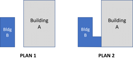

To illustrate the reasoning behind Sections 503.1.2 and 705.3, refer to the diagrams below. Both plans show what could be considered separate buildings: Plan 1 shows detached structures, and Plan 2 shows attached structures with a fire wall at the connection creating a court. Each building can have a construction type and occupancy groups that are not influenced by the other building's construction type or occupancy groups.
To be considered separate structures for Plan 1, an imaginary lot line is required to determine the fire separation distance for opening and exterior wall protection. The imaginary lot line cannot be placed in a location that would make the existing building (assume Building A) non-compliant with the building code. For Plan 2 to be considered separated structures, one of two options can be used per Section 706.5.1, of which #2 is the imaginary lot line applied similarly as described for Plan 1.
However, both situations can be considered portions of a single structure. Plan 2 would not require a fire wall, and both would require that the aggregate area of both buildings not exceed the allowable area based on the most restrictive construction type or occupancy group. The distance between the two buildings is irrelevant unless the court in Plan 2 is used as an egress court; thus, Section 1029 would come into play. Even if Plan 2 was constructed as one building with no fire wall, no one would question the distance between the opposing building faces at the court.
Therefore, if Plan 2 is acceptable as a single building without consideration of the distance between exterior walls, then Plan 1 should be equally acceptable as portions of a single building.
