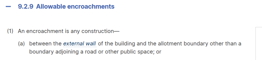

Hi,
I am after some clarification regarding 9.2.9 Allowable encroachments
Does this section refer to external walls of the building, as in stairs attached to the house?
I have a set of stairs that are not attached to the house going down a retaining wall for shed access.
These stairs run parallel to my fence line that faces a road and are 600mm off the fence.
My certifier has flagged this as an issue and sited this part of the NCC
3 - Encroachments allowed within 900 mm of an allotment boundary or within 1.8 m of another building, or its vertical projection, on the same allotment are—non-combustible fascias, gutters and downpipes; and light fittings, electricity or gas meters, aerials or antennas; and pergolas, sun blinds or water tanks (see Figure 9.2.9a); and unroofed terraces, landings, steps and ramps, not more than 1 m in height.
Just wanting to confirm if there is an issue or a misinterpretation of the code.
Thank you

At least you got one that cited a code section, that is a good sign that he probably knows what he is doing.
As an American, and only looking at the section you cited, I think that since the issue appears to be about fire spreading from one building or lot to another, if the steps are over 1 m in height, it would be a violation whether it was attached to the building or not.
I would call a few neighboring jurisdictions and ask what they think, to try to establish if there is a consensus on this issue. They are the ones who would be most likely to know.
Is it an encroachment at all?
Forgive my ignorance on your codes, but reading this section, and your description if it faces a road.....
