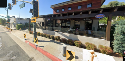

Not all bollards are created equal, and this is an area where standardization is essential. Some businesses have installed decorative bollards that serve no structural purpose, while others have used cheap bollards that are simply bolted into concrete and can easily shear off upon impact. To be effective, bollards must be designed to withstand vehicle strikes. The most reliable bollards are made of steel, filled with concrete, and embedded deep into the ground. Properly installed security bollards should extend at least three feet into reinforced concrete footings to ensure they are immovable upon impact. Newer bollard technology has also improved their effectiveness while maintaining cost efficiency. Crash-rated bollards, which meet ASTM or K-rated standards, are designed to stop vehicles of specific sizes traveling at set speeds. Some modern bollards feature energy-absorbing designs that reduce impact force, minimizing injury to drivers while still preventing vehicle penetration. The key is ensuring that regulations require tested and certified barriers, not weak, surface-mounted posts that provide little real protection. Addressing this issue in legislation will prevent opponents from arguing that ineffective bollards invalidate the concept entirely.

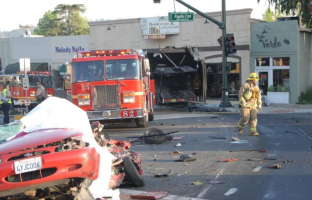

Beyond the financial impact, storefront crashes leave a trail of devastation. In Hingham, Massachusetts, an SUV plowed into an Apple Store at high speed, killing one person and injuring 19 others. The store had no bollards, despite being in a high-traffic shopping area with direct parking access. In Newton, Massachusetts, a driver with a medical condition lost control of his SUV and crashed into a pizzeria, killing two and injuring seven. A crash outside Farrell’s Ice Cream Parlour in California saw an elderly driver mistakenly accelerate into a crowd, killing a woman and seriously injuring a child. In Orlando, a vehicle pushed into a daycare center, killing a young girl and injuring 15. All of these incidents had something in common: they could have been mitigated or prevented entirely by properly installed safety barriers.
