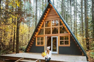

A-frame dwelling
Lots of images. Pitch varies. (Was there a consensus in another thread that 60° or greater from horizon was a wall, less was a roof?) I've seen 1,2, and 3 stories. Help?
2018 IBC
[BF] EXTERIOR WALL. A wall, bearing or nonbearing, that is used as an enclosing wall for a building, other than a fire wall, and that has a slope of 60 degrees (1.05 rad) or greater with the horizontal plane
So if it is a wall by definition, just use the IRC requirements for a wall? 2x4s 16" on center?

I don't have a reference to point to, just my gut instinct. I would consider it a roof system, not walls.
It's wall if 60° or greater from horizontal. Maybe the sample image isn't, but for that issue and the question, assume it is. If there was a ceiling near the apex and the thermal barrier was at the ceiling, then roof insulation (R49 here).
It's a bit of both. It's a wall when it's 60 degrees or more from the horizontal, but functionally it's a roof. I wouldn't trust any wall siding materials to shed enough water. The studs will probably have to be 2x6 or 2x8 because they would be longer than 12 ft. (IRC Tables 602.3(5)&(6)). It would be best to use rafter span tables to size the studs. This will be conservative for snow loads, but wind loads could be significant.
