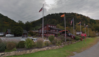

Years ago, my third-party agency was given a set of plans to convert an apartment house into a bar and restaurant. The plans involved major structural changes and, of course, change of use, so under the IEBC, this is a Level 3 AND Change of Use and Occupancy. The plans submitted were hand-drawn but signed by an engineer I had previously worked with. There were no MEP drawings, no accessibility, and no Life Safety, just hand-drawn concept drawings. I was completely shocked by the amateur and unprofessional level of drawings, so I contacted the engineer directly. He had nothing to say. I asked him why he would do such a thing and if he drew them himself, and he had no answer for stamping them but stated he did not draw them. I was honest and told him I was disappointed. At this point, we spent a lot of time on the plan review and sent out the very lengthy discrepancy report. We never received a reply, ever.
I drove by this location frequently to go scuba diving at Dutch Springs and watched the construction start and complete over the next few months. When I contacted the BCO about why we did not hear back, he stated that the owner did not like my plan review, so we sent it to another third-party agency that just approved it as submitted. This is the tip of the iceberg in Pennsylvania's poor attempt at a state-wide building code and a BCO with zero integrity.
Shirley, they went the wrong way....and apparently they are proud of that.

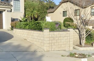

There are reasons for not obtaining a permit. My yard used to slope towards the street. It was grass and rabbit turds. More turds than grass. The city offered to pay me to remove the water hungry turf. So I got a building permit and built a retaining wall. The inspector came for the footing inspection while I was cleaning out the excavation with a ShopVac. He said that he's never seen anyone so meticulous with a footing and therefor he didn't bother to look at anything. He signed the card and away he went.
He returned several days later and crossed his name off the job card. He said that the wall shall be set back two feet. I showed him the approved plan that has the wall right where it is. I had the first few courses of CMUs in place and this inspector is telling me to start over. I called the BO and explained they had a shot at it and missed the target. He said that he would let it stand if I grew Ivy on the face of the wall. As you can see, I declined.
For a few hundred dollars and my time I had a dolt show up and waive the inspection. Since then I have replaced both HVAC systems, french doors with sliders, overhauled two balconies and a repipe without asking the city to be a part of it.
The point of the story is that code compliance abuse works both ways. I have seen the light. Okay I admit that I am not the typical civilian that should rely on a code professional to evaluate the result....but those civilians are just getting screwed...twice.
