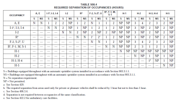

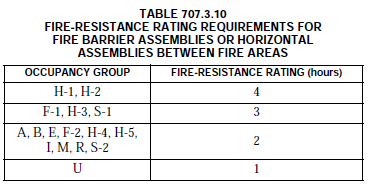

Okay -- possibility number 1: The architects may have split the building into fire areas. If the third floor is an A occupancy and the fourth floor is a B occupancy, if they are considered to be separate fire areas a 2-hour separation is required:
Beyond that, unless the building was designed as non-separated mixed uses, Table 508.4 requires a separation between an A occupancy and a B occupancy. It's 1-hour in a sprinklered building, 2-hour in a non-sprinklered building.
So, whether it has to be 1-hour or 2-hour, the shaft is required and has to be rated because the duct connects an A occupancy with a B occupancy. Since the architect enclosed the duct(s) in a shaft on the fourth floor, the point where the ducts enter the protected (rated) enclosure is the fourth floor, so that's why a fire damper is required at that point.

My gut is telling me that this building was designed as separated mixed-use, meaning there is a fire-rated separation between the A occupancy on the 3rd floor and the adjacent B occupancy spaces. If the building were designed as non-separated mixed-use under type IIB construction, it would be limited to just three stories due to the A occupancy classification.
Unless the A is accessory....
