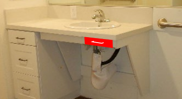

Here's a photo from a presentation by LA Housing Department's Neutral Accessibility Consultant:
It is not uncommon to have side panels remain that comply with knee and toe clearance, and to have it be accepted as reasonably equivalent to the allowable dimensions of the lavatory itself.
Note that this is an exception, approved "on a case-by-case basis." It is not the code or the ADA or UFAS.
I talked to the NAC about this during the seminar - - specifically, why does it need to be on a "case-by case basis"?

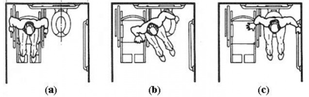

The ADA Standards shows an illustration that shows a countertop only - - it does not show a side bracket:
However, ADA 604.3.2 does allow "associated... shelves" as well as other items within the clear floor space for the toilet. Shelves typically have support brackets, so the NAC would allow the vanity countertop to have a bracket, given that the countertop functions as a type of shelf adjacent to the toilet, which complies with 604.3.2.
What is not allowed is "cabinetry". A cabinet is a type of enclosed storage, which is not explicitly allowed in 604.3.2 and is thus considered an obstruction. So the NAC wants to confirm the encroaching bracket space isn't also being used for storage, such as the red drawer shown below:
Thus the NAC reviews the designs on a case-by-case basis.
Even allowing a bracket such as shown within the maneuvering space for the water closet relies on the revolving cones model, which has never been part of the code but which has been used by some jurisdictions "on a case-by-case basis" to allow modifications. The revolving cone model basically takes the knee and toe clearance dimensions for under sinks and spins it into a 360-degree circular solid, on the theory that if it works under a sink, it works anywhere.
But there's nothing in the ADA, UFAS, or A117.1 that says this can be applied to the clear space for a water closet. Where it is allowed, it is by exception or modification granted by the AHJ.
As mentioned in post #5, the vanity countertop does not rely on the revolving cone model for code compliance; it relies on the vanity countertop being considered either as part of the lavatory, which is allowable encroachment in residential dwelling units, and/or as an allowable associated shelf.

I hope you don't have to suspend the front of the counter from the ceiling by a cable, which would be the only way you could meet the Guide to ADA Standards drawing if somebody took it literally.
A countertop itself doesn't rely on the revolving cone model, but an articulated side support bracket such as shown in post #3 absolutely relies on the revolving cone model -- and none of the accessibility standards explicitly allow or endorse that model.
I repeat, there is nothing in 604.3.3 that limits the dimensional extent of the of an allowable overlap into the toilet space. They could have a 12” thick solid floating “associated shelf” instead of a 2” thick shelf with 10” long side brackets, and that floating shelf would comply with 604.3.3.
Once you have determined that the vanity counter is either a part of an allowable lavatory or is an allowable associated shelf, it Is an allowable overlap. Period. No need to refer to rotating cones to justify it. A rotating cone clearance at the overlap may be “best practice”, but it is irrelevant to the code compliance of the shelf support.
