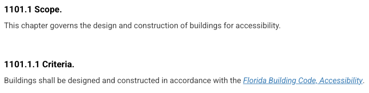

Florida does things a little differently than most other states. Although the FBC is essentially the IBC with Florida amendments, regarding accessibility, Chapter 11 is marked as RESERVED other than a few sentences. The following are the only two code sections in Chapter 11 of the FBC. Everything else is blank because Chapter 11 was rewritten in the FBC Accessibility code, which is the ANSI A117.1, but with Florida amendments, which includes portions of the FBC.
Chapter 11 of the IBC provides the scoping requirements for accessibility through the ANSI A117.1. In Florida, all of the scoping is integrated into the FBC Accessibilith in Chapter 2. Whereas the ANSI A117.1 Chapter 2 only has three sections, 201, 202 & 203, the FBC Accessibility goes all the way to Section 243 as this Chapter 2 replaces Chapter 11 of the FBC.
