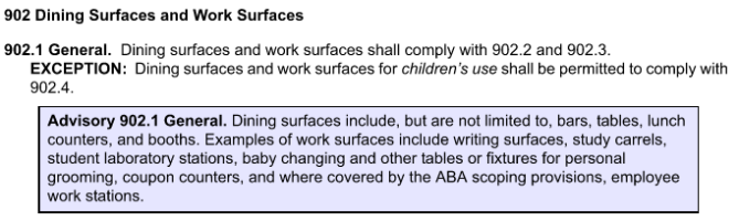

Here's what the Dept. of Justice advises regarding worksurfaces covered under ADA:
No way to answer that, because of how "work" may be defined. I would assume it is largely a space for coffee cups, file folders, maybe some code books, places for people to put their briefcase. Typical building, planning, public works department type stuff done in every conference room. I imagine all "work" of the type I imagine would take place on the conference table. Since it has doors from both the back of house and the front of house, it will be used by the public for meetings with the administrators, inspectors, building officials and planning officials. I don't think it would be required, but I want it as clean as possible since it is a government building. I don't want an applicant angry over an inspection failure due to accessibility to be able to be able to point out that the building department's own building isn't accessible. I do that enough all by myself.
If the counter is used for setting code books, briefcases, etc., then it is a type of storage, not a worksurface, and the upper height can be 46"-48" depending on base cabinet depth (ADAS 308).
If the intent is for people to drink their coffee and eat their food while seated at a table, then even if someone sets their own cup of coffee on the counter to avoid spilling on the documents at the table, it might still be regarded as a shelf.
However, if someone puts a clipboard on the counter with intent to have a sign-in at that location, now it's a worksurface. If someone sets self-service buffet food line there, it might be a worksurface. If someone sets the coffee service (cream, sugar, stirrers) there and expects people to prep their coffee at that location, IMO they made it into a worksurface.
In my opinion, better to plan from the start for 34" height. If it's already in place at 36" and you are out of budget, you will have to manage it so that it doesn't function as a worksurface.
