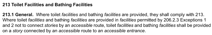

In CT mezzanines under 3,000 sf where the same goods and services are provided in accessible areas are not required to be accessible.
So if i have a toilet room on a 1,500 SF mezzanine, where we have toilet rooms on the main level, they fixtures don't need to be accessible???
Some how this just feels wrong. LOL But yet it doesn't make sense to have a low urinal or grab bars if its not accessible.
Any thoughts.
IBC Section 1104.4 exempts the accessible route to the mezzanine level. It does not exempt the fixtures on that level from being accessible.
Check out IBC Section 1109.2 to see if the toilet room qualifies for any of the exemptions for being accessible.

I'm with classicT...Not sure if OSBI ever opined on this....Just because the route is exempted, it does not necessarily exempt all features...Such as braille signage....
The 2010 ADA Standards, Section 213.1, requires accessible toilet facilities on an accessible route. There is no mention about toilet facilities on nonaccessible stories permitted per Section 206.2.3 Exceptions 1 and 2.
However, the mandatory language in the first sentence of 213.1 ("Where toilet facilities [...] are provided, they shall comply with 213.") and the first sentence of 213.2 ("Where toilet rooms are provided, each toilet room shall comply with 603.") leads me to believe that if the toilet rooms are located on a nonaccessible story, they must still be accessible, and that other accessible toilet rooms must be located on an accessible route per 213.1. This is similar to the IBC section that @classicT provided.
2010 ADAS:
I agree that 213.1 is to be interpreted that the interior features, fixtures, and clearances of a toilet room on a nonaccessible story or nonaccessible mezzanine must be accessible, even if the toilet room is not on an accessible route, for the reasons mentioned by Classic T.

2010 ADA Standards for Accessible Design: Advisory 206.2.3 Multi-Story Buildings and Facilities. "Spaces and elements located on a level not required to be served by an accessible route must fully comply with this document."

213.1
General. Where toilet facilities and bathing facilities are provided, they shall comply with 213. Where toilet facilities and bathing facilities are provided in facilities permitted by 206.2.3 Exceptions 1 and 2 not to connect stories by an accessible route, toilet facilities and bathing facilities shall be provided on a story connected by an accessible route to an accessible entrance.
213.2 Toilet Rooms and Bathing Rooms. Where toilet rooms are provided, each toilet room shall comply with 603. Where bathing rooms are provided, each bathing room shall comply with 603.
