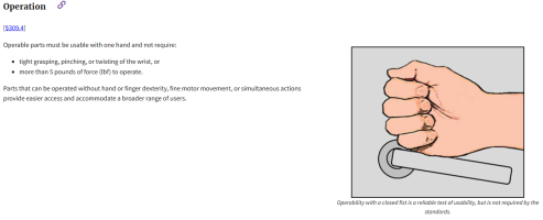

ADA / 11B-606.4 requires that kitchen faucets comply with 309 (no tight grasping, pinching, or twisting of the wrist).

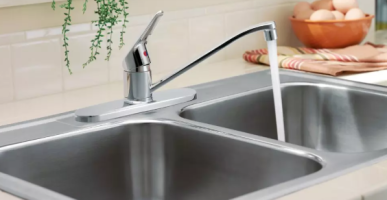

1. A sink is supplied with both an accessible faucet and a second, separate handheld sprayer wand. You grasp and pull the wand/handle to make the nozzle point into the sink, and you grasp / press the button on the wand to make the water come out.
The sprayer is also located towards the rear of the sink (check reach depth vs. waste disposal obstruction below).
Question: if the main faucet complies, must the accessory wand also comply? ADA/11B-212.3 only requires 5% of each type of sink to be accessible. Does that imply that only 5% of water-emitting devices at a sink need to be accessible?
2. In this scenario, the wand is integral to the main faucet spout, but it has a button selector for different spray controls. Still requires grasping and pinching to fully depress the button:

Is the kitchen sprayer button that much different than an elevator button or the buttons on the front of a vending machine? I’d say it’s OK.
There are faucets where the nozzle sets into a rigid sleeve that enables it to function with the push of a button, no grasping required:
There are other nozzles that do not retract into a rigid, but instead permanently dangle down. These are loose, and require grasping in order for the button to depress. Is it "tight" grasping? I don't know. But if I had no opposable digits, I couldn't change the spray control:
