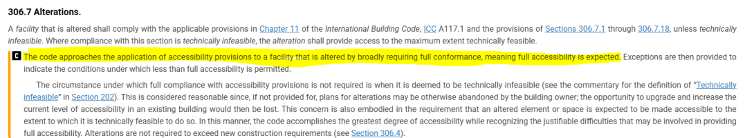

Why not? IEBC 305.7 says "the route to the primary function area shall be accessible. The accessible route to the primary function area shall include toilet facilities and drinking fountains serving the area of primary function." The way I read this, you need to provide an accessible route (toilet rooms) to the area of primary function. If each suite is its own area of primary function, then a toilet room for each suite (or one for all suites) should be provided, no?

It's IEBC 306.7.1 in our IEBC, but that section is immediately followed by a laundry list of exceptions. Exception #1 is:
The costs of providing the accessible route are not required to exceed 20 percent of the costs of the alterations affecting the area of primary function.
This means they don't have to make any toilet room 100% accessible if the cost of doing so exceeds 20% of the project cost attributed to the alterations affecting the area of primary function. And if they spend the 20% on accessibility improvements to other portions on the accessible route, they don't have to spend a nickle on toilet room improvements.

I thought the ADA had a priority order (non-mandatory) for where the 20% should be spent first, but I can't find it. I did find this advisory in he 2010 ADAS:
Advisory 202.4 Alterations Affecting Primary Function Areas. An area of a building or
facility containing a major activity for which the building or facility is intended is a primary
function area. Department of Justice ADA regulations state, “Alterations made to provide an
accessible path of travel to the altered area will be deemed disproportionate to the overall
alteration when the cost exceeds 20% of the cost of the alteration to the primary function
area.” (28 CFR 36.403 (f)(1)). See also Department of Transportation ADA regulations,
which use similar concepts in the context of public sector transportation facilities (49 CFR
37.43 (e)(1)).
There can be multiple areas containing a primary function in a single building. Primary
function areas are not limited to public use areas. For example, both a bank lobby and the
bank’s employee areas such as the teller areas and walk-in safe are primary function areas.
Found it. It's in a guideline from the Access Board: https://www.access-board.gov/ada/guides/chapter-2-alterations-and-additions/
Prioritization​
Compliance is required up to the point the 20% cost cap is reached, even where it does not result in a fully accessible path of travel. Where costs exceed this cap, compliance should be prioritized in this order:
  1. an accessible entrance
  2. an accessible route to the primary function area
  3. restroom access
  4. an accessible telephone
  5. an accessible drinking fountain
  6. access to other elements such as parking and storage
"Should," of course, is not mandatory language
