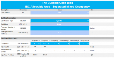

If the most restrictive occupancy is S-1 and the building has open frontage all around it (I checked a map), why wouldn't this all fit within the allowable area as one building and therefore no separation required at the walkway/tunnel? 17,500 + 13,125 = 30,625 SF allowable area.
I am unsure where the lot line is on the east side, but they can probably get enough allowable area to cover the entire building area without using fire walls. However, to avoid sprinklering the building, they must have fire barriers to keep any single Group S-1 fire area from exceeding 12,000 sq. ft. and the aggregate area of all Group S-1 fire areas from exceeding 24,000 sq. ft.
At a quick glance it looks like it exceeds the 17,500 SF (plus open perimeter increase) area limit for unsprinklered S-1, which is the more restrictive occupancy, in IBC Table 506.2. Since it doesn't comply with the exception #1 to IBC 705.3, exterior walls have to be fire-resistance rated in accordance with Tables 601 and 602.
ok, If I'm a IIB construction and B occupancy, then as non-sprinklered, I'm allowed 23,000 sq ft on 2018 IBC (applies at this site), and 100% of perimeter is over 20' clear to PL or wall on site, so 75% increase gives me 40,250 sq ft. My total is 24,894 sq ft, so no sprinkler required.
Tabel 508.4 says B-S-1 occupancy, "N" no fire separation. Where am I wrong?
Seems right to me.
