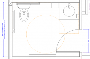

This is one of two bathrooms, both are approximately 84" x 109"
Only thing in each bathroom is a toilet and a sink.
The sink vanity is corner wall mounted and is 32" wide with the sink in the middle, they are straight forward approach or you could always come at anything from the side.
When you say "corner wall mounted", do you mean something like this?
Tom....If they are both on the same "wet wall" you need about 7'1" finished/ clear to make it work depending on lav sizing FYI.....
Build a +-20” deep bulkhead (furred wall corner) for the toilet, so that the vanity is recessed into an alcove behind the open side of the toilet. Now there’s plenty of room for the 60” wide toilet clearance, and ADA only requires a 24” wide rear wall grab bar.
What is the distance from the side wall to the paper towel dispenser? dispenser height to operating device?
I don't see anything incredibly alarming. A few items to measure and verify.
One thing that I can see for sure is that the flush control is on the wrong side of the tank.

Bathroom layout for reference, the second unit is a mirror of the first, all the fixtures were donated for this project.
