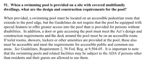

I see that this is an interpretation specific to Florida's state accessibility laws, and it concerns a multifamily development where the swimming pool is used only by residents and their guests, and not the public. But what about the Federal Fair Housing Act for Multifamily dwellings?
See excerpt below from the HUD/DOJ joint statement on the FHA:
https://www.fairhousingnc.org/wp-co...cessible-Design-Construction-Requirements.pdf
And here's the specifics for pools:
It also should be covered under the FAIR HOUSING ACT

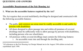

The Fair Housing Act does not distinguish between different forms of ownership when determining whether a unit or building is covered. Condominiums are covered by the Fair Housing Act even if they are pre-sold as a shell and the interior is designed and constructed by the buyer.

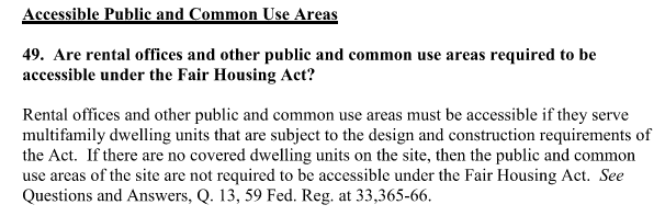

The path of travel to and placement of site amenities, such as outside mailboxes, refuse disposal areas, swimming pools, clubhouses, and sports facilities should be given careful consideration early in the planning process. The intent of the Fair Housing Act is that people with disabilities be able to reach and use such amenities.
The swimming pool, picnic area, and playground are site amenities building and must be reachable by an entrance accessible route; in this example, a road and accessible parking are Careful Site Analysis and Building Placement in the not required since there is an Planning Stage of a Housing Development Makes accessible pedestrian route

I took a brief look at the Florida Building, Accessibility (2010). I am in agreement with tbz and Yikes, because I don't think Florida can enforce a federal law by reference. They can enforce their own written statewide agreed and accepted accessibility code that can be sent to the DOJ to see if they deem it equivalent but only the DOJ can enforce the ADA. If you read the FHA statute which is the 1991 Guideline there is no scoping for how to access a pool for the multifamily development. From my reading of the FHA statute it only requires an accessible route to and from the pool area that also includes mail box areas.
Hello Jar -
Fair Housing Act - Rules and Regulations page 9487 left column 5th paragraph.
Department has decided not to change the specifications for recreational facilities, including swimming pools, as provided by the Option One guidelines, since there are no generally accepted standards covering such facilities. Thus, access to the pool area of a swimming facility is expected, but not specialized features for access into the pool (e.g., hoists, or ramps into the water).
