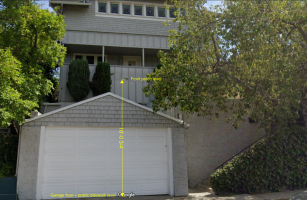

Background first, then 3 questions:
I have a not-for-profit client that for many years has operated an R-2.1 group home licensed for persons with mental disabilities.
They are accepting a federal-based grant to renovate the home, which makes it public housing subject to ADA and CBC-11B, and it needs a path of travel from the street to the front door.
The home is on a very steep hillside site. I would like to convert the garage into a new street entry foyer room (zero parking required in this zone), then install a residential-type elevator that leads from the garage up to the level of existing front porch (about 18' rise), opening onto a bridge that connects to the porch. So, the path leads from the interior of the former garage, back out to the exterior of the porch, then into the main house.
ADA/CBC 11B-409.1 defines private residential elevators as being "provided within a residential dwelling unit required to provide mobility features complying with 809.2 through 809.4".
  • Q1: Is an R-2.1 Group Home considered a type of residential dwelling unit?
  • Q2: When my elevator starts inside the new foyer (former garage) at the bottom, and exits outdoors before re-entering the main house, does it still qualify as "within" the dwelling unit?
  • Q3: Because this is an alteration project, but not a "substantial alteration", it is not REQUIRED to provide all the mobility features of 809.2 through 809.4. Is it still appropriate to utilize a 409.1 private residence elevator to satisfy path-of-travel requirements?

IMPO; Yes, it is a residential dwelling unit(s). That is why it has a R, as a designation.
IMPO; No, it is not within. If they were to enclose it then yes.

We are not replacing kitchen cabinetry or bath cabinetry, so per USDOJ we are not triggering "substantial remodel" in CBC 11B.
Yes, the owner does have an ongoing obligation to comply with ADA to the maximum extent feasible.
Their government funding source will not finance additional square footage (footprint). They will only finance alterations of existing square footage (footprint). The existing house was built in 1914 and it is technically infeasible to provide an accessible route to through top floor of the house. The hallways, doorways, etc. are too narrow. The place would be a tear-down.
But your point is well taken. The house is located in L.A. , so I may as well get a finding from LAHD's Neutral Accessibility Consultant (even though LAHD is not financing the project).
