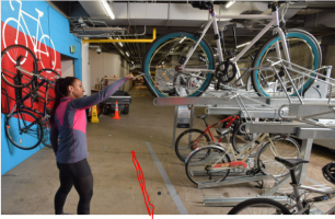

Our products upper unit protrudes more than 12 inches than the lower unit. As mentioned a "cane guard" can be incorporated to make up for this. However, we need a "cane guard" that also allows the lower bikes to still roll into the lower unit.
My main question is what can be classified as a "cane guard" and what is the minimum height needed off the ground to be considered acceptable?

Can you send us a link that shows the actual type of rack your are trying to install (not just the ADA generic diagram)?
Here is the link to the product we want to install. Any dimensions can be found in the "Architect & Contractor Toolbox" section
Thanks, A picture is worth 1000 words.
A "cane guard" is some object below 27" in height that lets a visually-impaired cane user hit it with the cane first, before they smack their body on the rack or other object:
Options include installing max. 27" high rails, or perhaps wing walls at either end of your bike racks, similar to the old illustration below for a bank of public telephones. Note that this illustration assumed people were walking parallel to the phones, not straight towards them. The 4" rule is for wall-mounted objects, and 12" is allowed for post-mounted objects.
In the photo you provided (below), if people will be walking directly towards the racks, I've sketched a red line that could (for example) be a very low curb.
It runs continuous for the length of the rack assembly, and is within 12" horizontally of that handle the woman is holding.
How tall does the curb need to be in order to be detected by a cane? The code doesn't say. I've seen 4", but maybe you could get away with 1" or 2".
Maybe if it's really low, you want to change the pavement texture to the right of the red line, so that a cane user can get an extra warning they are entering a more hazardous area.
