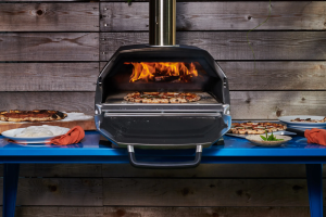

Easing into the summer season, I'm trying to ensure that BBQ grills at a public housing project are ADA/CBC 11B compliant. Many charcoal "park" type grills have heavy lids that exceed 5 lbs. opening force. Some have a latching brace that requires 2 hands to unlatch/close the lid, or 2 hands to raise and lower the grill.
California CBC 202 defines "kitchens" as "area with equipment... for cooking of food", which makes the BBQ a type of kitchen appliance per 11B-804.6
Here's how I think it could still be compliant:
11B-804.6.2 exception #1 does not limit the control height, and exception #2 says that bottom-hinged doors do NOT need to comply with max. 5 lb. opening force, pinch/grasping/ one-hand operation, etc.
My question: would you consider the BBQ lid below to be a "bottom-hinged door"? It certainly looks that way when opened.

No sink, no water, no countertop provided = no preparation can be done therefore not a "kitchen" by definition
It is a charcoal grille. Not an easy grille to use by an able-bodied individual.
No. A bottom hinged door would be like a tradition kitchen oven.
A traditional kitchen oven has a hinge on the bottom when it is in the up position, and when in the down position the hinge is on one side.
The BBQ lid shown in the photo has a hinge on the bottom when it is in the up position, and when in the down position the hinge is on one side.
How is one bottom-hinged and the other is not?
11B-804.6.2 exception 2 doesn't mention anything about the 5lbs requirement. Exception 1 does, but there's no specific requirement for hinge location.

Edit: I'd say that this is a bottom hinged door in regards to exception 2.
