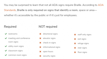

Hello,
I can't seem to find an exact requirement for which rooms signs require (or don't require braille). When I do my searches. I mostly find commercial sites posting their interpretations. But not a cut and dry requirement from ADA. I'm pasting one such example, because I'm not sure if it's accurate or not.
Thank you!

Do note that the IBC Sections I posted are just specifying where signs for accessible elements are required.
Where providing signage that is not required, you may still need to provide signage that is accessible. The "provide it for some, provide it for all" concept.
As an example, a sign indicating the use of a room or a room number, is not required per the code. But if you provide such sign, it should be provided with raised characters and braille to avoid discrimination.

If the jurisdiction has adopted IBC Appendix E, (2015), they can enforce Section E107.2 which states, Destinations. Interior and exterior signs identifying permanent rooms and spaces shall be visual characters, raised characters and braille complying with ICC A117.1. It gives a couple of exceptions for exterior signs, directories, and temporary signs.
2010 ADA Standards: You have to start in Chapter 2, Scoping Requirements. That will then direct you to the applicable technical requirements in the other chapters.
"216.2 Designations. Interior and exterior signs identifying permanent rooms and spaces shall comply with 703.1, 703.2, and 703.5. Where pictograms are provided as designations of permanent interior rooms and spaces, the pictograms shall comply with 703.6 and shall have text descriptors complying with 703.2 and 703.5."​
"216.4.1 Exit Doors. Doors at exit passageways, exit discharge, and exit stairways shall be identified by tactile signs complying with 703.1, 703.2, and 703.5."​
"703.1 General. Signs shall comply with 703. Where both visual and tactile characters are required, either one sign with both visual and tactile characters, or two separate signs, one with visual, and one with tactile characters, shall be provided."​
"703.2 Raised Characters. Raised characters shall comply with 703.2 and shall be duplicated in braille complying with 703.3. Raised characters shall be installed in accordance with 703.4."​
"703.3 Braille. Braille shall be contracted (Grade 2) and shall comply with 703.3 and 703.4."​
"703.5 Visual Characters. Visual characters shall comply with 703.5."​
Directional and informational signs and accessible means of egress directional signs do not require tactile characters (neither has a reference to Section 703.2), just compliance with Section 703.5, which only requires signage with visual characters of a certain size, stroke, spacing, and contrast.
Permanent room/space signs are not required, but if you do provide them, then you have to have visual and tactile characters (raised letters and braille). Exit doors are required to have signage with both visual and tactile characters. Restrooms need only provide signage per Section 703.5.
Note: you are dealing with 2 issues, one is code related (not all states are equal is what as required and at a minimum the other is ADA (Federal Law), both are nor necessisairily required.
If you provide signs they must at a minimum comply with ADA as RLGA has indicated above.
Venders are not always up to date on each states requirements.
