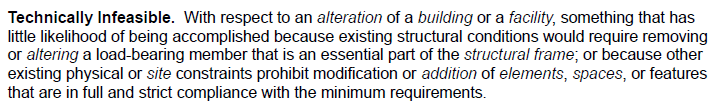

I don't find anything "lol" about accessibility or the ADA, and technically there isn't much open to interpretation about what "infeasible" means after the ADA has been in effect for more than three decades. Here's the definition, from the 2010 ADAS:

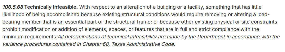

Here it is from the Texas Accessibility Standard:
Except for the advisory sentence at the end, in italics, the Texas definition is the same as the ADAS definition. If you are working in an open, empty space, pretty clearly nothing is "technically infeasible" according to this definition.
Overall, the Texas TAS follows the ADAS very closely.

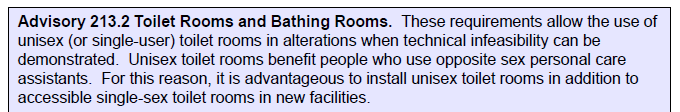

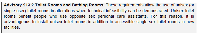

The ADAS offers the following comment after section 213.2:
Same advisory comment in the TAS:
The bottom line is that you would have to demonstrate to the Department that you meet the definition of infeasible. I think there's no question that you do not.

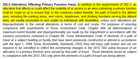

Please confirm “yes” or “no’ to each of the following:
1. Your proposed project is an interior alteration within an existing structure, like a tenant improvement.
2. The multi-user restrooms are already existing, either within the alteration space or elsewhere in the building.
3. If #2 is “yes”, the multi-user restrooms are not themselves proposed to undergo alteration.
See TAS 202.4.

Per TAS 202.3, the new multiuser restroom is an alteration to the existing shell space and all new restrooms must comply with the scoping requirements of TAS 213.
Since it is new and not existing, and I don’t see any scoping exceptions within TAS 213, the new multiuser restroom must be made accessible.
