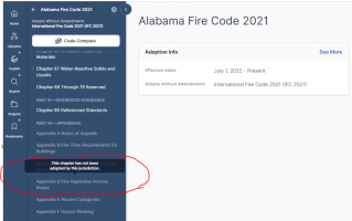

I see that you are registered in Alabama, and if the project is located there, then I note on Upcodes that Alabama did not adopt IFC Appendix D.
@Yikes, thank you! The project is located in Oxford Mississippi and the municipality has adopted the 2018 IFC and all appendices.

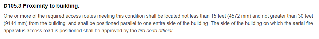

I suppose we can ask about the meaning of "an aerial access road positioned parallel along one entire side of the building". That code language is vague. There are two sides of the building that will be near access roads, but they are the short sides.
D105.3 is written to give the local fire official complete discretion as to whether the apparatus access road must on a long side, or can be on a short side.
For example, here in the Los Angeles area if you are located in unincorporated LA county or if your city contracts for fire services with LA County, then LACoFD has issued their own interpretation that their aerial access road MUST be placed on which ever side of the building is longest.
This can be very difficult in the situation you have described, or when you have a U-shaped building where the courtyard opens up to the street and the longest side is the very back yard. I've seen all kinds of workarounds, like having curved facades so that the elevation wraps around the corner in one continuous facade. The LACoFD staff are notoriously inflexible if it is a brand new development or tract map, but if you get the right person on the right day, you can get a sympathetic ear for existing land parcels.
