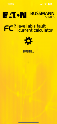

We recommend this app that they can use on their phone and send a PDF label right to their permit via email from the app.
It will generate this PDF with the calculation:
