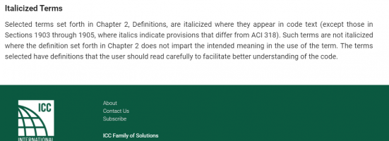

My jurisdiction is still working out of the 09 I-codes. So, just curious how others interpret this. 412.4.1 states that "Exterior walls located less than 30' from a lot line or a public way shall have a fire-resistance rating not less than 2-Hr." Now this is a III-B building. Per the arch I am dealing with here, he gets to go to "Exterior Walls" and completely disregard the language in 412.4.1. If that section made reference to another code section or provision, I might agree. But not in the code, nor the commentary does it take you to another section of the code. He is stating that because the word "Exterior Walls" are italicized, he gets to go to exterior walls and use the 602 table to determine the fire-resistance rating of the wall. Am I completely off base here? How does one just discard the specific language of a code section?
That's what I believe as well. I also realized that I left a very key piece of info out. This particular exterior wall is located 6.5' from the assumed property line. There will be another hanger in the future 13' away from it.
Table 602 footnote g will send him to the 30 ft requirement in 412.4.1

412.4.1 Exterior walls.
Exterior walls located less than 30 feet (9144 mm) from lot lines or a public way shall have a fire-resistance rating not less than 2 hours.

Did you say Type IIIB construction? According to IBC Table 601, exterior bearing walls need to be 2 hour fire-rated. To reiterate what MtLogCabin already said, just go ahead and let him use the next Table 602. Just be sure he looks carefully at footnote "g". And if he wants to insist on anything less than a two-hour fire-rated wall, then he needs to either move the building or the property line so that there is 30' in between.
Then there is the architect saying the italics mean they have the option to refer table or not.
