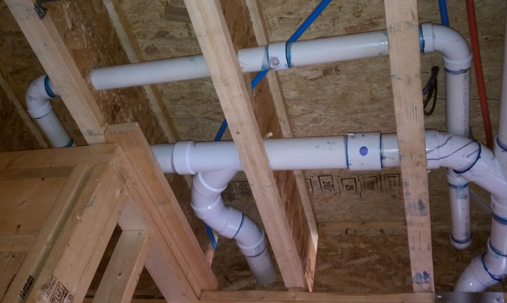

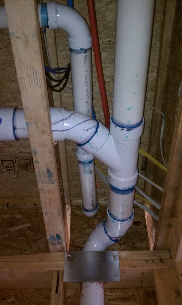

There surely must be an easier way to vent than this:
There is an issue visible however. Can you see it?
Without seeing the rest of it, I can really tell. 2" pipe pitched too much (if that's a drain), or vent connection not above the midline (if it's a dry vent), maybe vent connection upstream of the WC connection? dunno..
Is the 3" connecting to the 2" on the left side of the photo?
Is that an approved 1/8 inch thick steel plate connector or some furnace tin? Holes drilled to close to the bottom flange on a I-joist.
This job will make the puple primmer guys happy except where they may have not glued the 3" DWV at the wye!
