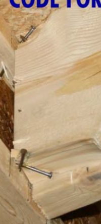

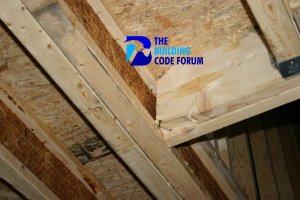

This was the framing of a stairway opening to the basement. Once again, it was signed off by the third-party building inspector. I was there as a private inspector to oversee the construction of this house. What else did this inspector pass that was an obvious code violation?

Not sure I see a problem. Three or four nails seem pretty strong. Ehh,...... I would guess at four since its attached to the I-joist at top and bottom. Yup. Four is the right way to go.
Never nail into the side of an I-joist flange as it may split the flange depending on what it is made of, Laminated material or dimensional lumber.
Bottom flanges like the bottom cord of a truss are very limited in what PSF they can support.
Notice the split and the missing chunks of wood at the top and bottom where the nails are.
