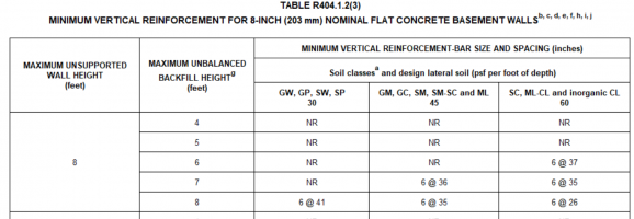

Hello
I'm building a single family home on Long Island NY with an 8' basement and no issue with soil in area.
Our foundation and rebar was originally the following on the plans see below... Note the 40" OC for #6 rebar.
The architect asked an engineer to review their plans and they changed the spacing to 35" O.C... Is this overkill what is the code for rebar spacing? For anyone who's building in NYS or North East what did your foundations call for with rebar gauge and spacing?
8" POURED CONCRETE FOUNDATION WALL W/ #6 REBAR @ 40" O.C. VERTICALLY & #4 REBAR @ TOP, BOTTOM, & 1/3 POINTS HORIZONTALLY ON 10"x20" CONTINUOUS FOOTING W/ (3) #4 BARS, SEE SECTION/DETAIL
Thanks

Table R404.1.1-2 is for masonry block foundations. Your original post stated a poured concrete foundation wall which would be Table 404.1.2(3) that I posted above. Yes, the table states the spacing # 6 @ 41" OC based on the SP soils you have would be the minimum you are required to do.
Remember the codes are a minimum requirement or put another way the worst building you can legally build.

R404.1.3 Concrete foundation walls.
Concrete foundation walls that support light-frame walls shall be designed and constructed in accordance with the provisions of this section, ACI 318, ACI 332 or PCA 100.

TABLE R404.1.2(8)
MINIMUM VERTICAL REINFORCEMENT FOR 6-, 8-, 10- AND 12-INCH NOMINAL FLAT BASEMENT WALLS b, c, d, e, f, h, i, k, n, o
m. A plain concrete wall with a minimum nominal thickness of 12 inches is permitted, provided that the minimum specified compressive strength of concrete, f ¢c, is 3,500 psi.
