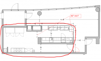

Are A2 kitchens considered 1103.2.2 Employee Work Areas?
Section 804 applies more aptly to personal type kitchens like those found within a dwelling or a break room.
What I'd say is that you need to focus on 1104.3.1, as is required by 1103.2.2. Given this, I would then suggest that you have a doorway without a door at the detailed 3-ft opening. A minimum 36-in opening is required wherein the opening has a depth of more than 24-in per the Accessibility Code (404.2.2).

Common use circulation paths, located within employee work areas that are less than 1,000 square feet (93 m2) in size and defined by permanently installed partitions, counters, casework or furnishings, shall not be required to be accessible routes.
Note that this exception (WI BC 1104.3.1, Exception #1) may apply, thereby exempting the kitchen from having an accessible route that allows for approach, entrance, and exiting of the work area.
Hard to say from the image provided, but I'd speculate that you are less than 1,000sf.
With an A2, in a scenario like the following, the areas circled are considered 1103.2.2 Employee Work Areas and are not considered accessible kitchens per 804.2.1.
Therefore, the 40" min clearances outlined in 804.2.1 do not apply.
Would that be a correct interpretation?
I would agree. That said, I think it would be a mistake to design a commercial kitchen that doesn't have the required access dimensions. Remember that, although employee work areas are generally exempt from need to be designed for universal access, if a qualified job candidate applies for a job and is the best candidate -- or if a current employee becomes disabled but is still able to perform the work with reasonable accommodation -- the employer is required under the ADA to provide the accommodation. That's usually not difficult in a typical office setting, but it could be a challenge in a kitchen.
Yes, a commercial kitchen is considered an employee work area, and needs an accessible path (door with clearances) to the area. After that the equipment itself is not required (in most states) to either be accessible or on an accessible path.

This made me curious, so I looked at the OP... the OP does not say that this is an office kitchen. To me it looks more like a small cafe. OP indicates an A-2 use; whereas a small break room type office kitchen would likely be an accessory use and classified as a Group B.
I did not see the "With an A2..."
If it is a small café, it would also be a "B".
Whether it is a "B" or not does not effect the accessibility.
If it is a Commercial kitchen, it does not need to be accessible.
If it is a Kitchen in an office it does need to be accessible.

28 CFR Part 36, Appendix B to Part 36 - Analysis and Commentary on the 2010 ADA Standards for Accessible Design
206.2.8 of the 2010 Standards exempt common use circulation paths in employee work areas from the requirements of section 402 where it may be difficult to comply with the technical requirements for accessible routes due to the size or function of the area
Common use circulation paths within employee work areas that are less than 1,000 square feet and are defined by permanently installed partitions, counters, casework, or furnishings are exempt. Kitchens in quick service restaurants, cocktail bars, and the employee side of service counters are frequently covered by this exception
2010 ADA Standard 804.2, [Kitchens and Kitchenettes], Clearance, Exception, states, “Spaces that do not provide a cooktop or conventional range shall not be required to comply with [Standard] 804.2.” In other words, the cook-top or range is the trigger for when the kitchen or kitchenette ADA laws apply.​
