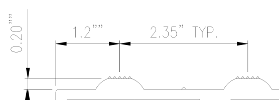

I received this at a shop drawing submittal for truncated domes.
https://armor-tile.com/assets/ada-c-3648w.pdf
It shows multiple "micro-dots" both on the domes and between the domes, and the micro-dots are described elsewhere on plans as 0.1875" dia. x 0.0625" high. I presume these are for grip.
The detail aslo shows the microdots as being above the 0.2" truncated dome height, making them taller than 0.2":
ADAS / CBC 11B shows these domes as having a flat top.
In your opinion, does this submittal meet code?

I don’t think California gives me the option to go with grooves. In 11B-705, Directional texture is reserved for transit platforms.
I think I’m stuck with truncated domes no matter what. Do these comply?
11B-705.3 Product approval. Only approved DSA-AC detectable warning products and directional surfaces shall be installed as provided in the California Code of Regulations (CCR), Title 24, Part 1, Chapter 5, Articles 2, 3 and 4. Refer to CCR Title 24, Part 12, Chapter 11B, Section 12-11B.205 for building and facility access specifications for product approval for detectable warning products and directional surfaces.

Yes, the micro-dots "are for grip".
Without them, the pads are slippery when wet.
I agree they are important. My question: is the height of the microdots to be included when measuring the code required 0.2" height of the truncated domes?
If "yes", then almost none of the manufactured truncated dome fiberglass panels comply.
