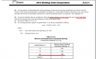

Area limit of individual unprotected opening
sunyaer
Apr 21, 2022
338
Toronto
Is there similar requirement of limit for individual unprotected opening in part 9? (the following screenshot is from part 3 3.2..3.1.(5)
