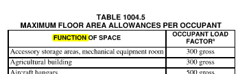

The reviewer needs to keep in mind that table 1004.5, which determines occupant load factor, relates to "function of space", not "occupancy classification of space". So if the reviewer is looking at that table and sees "Assembly without fixed seats - unconcentrated (tables and chairs)" at 15 SF/person, that does not compel it to become an assembly occupancy any more than your dining table at home would be considered an assembly occupancy.

Table 1004.5 for determination of occupant load does not say "occupancy classification of space" - - it says "function of space".
Once the occupant load count for each space has been determined, either by "function of space" in Table 1004.5 or its exception to reduce occupant load, then the next step is to see if that resulting count is less than 49, which then changes the occupancy classification per 303.1.1 or 2.
Can you help me understand why you say the martial arts studio is an A occupancy when 304.1 (list of Business Group B examples) includes martial arts studios?
For purposes of building height and allowable area, it is a B occupancy classification. For occupant load, under Table 1004.5 I would look at Exercise Room for the function, and if the resulting occupant load is 50 or more that makes the space an assembly use within a B occupancy group.
