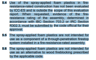

Any penetrations of the gwb, 2024 IRC refers to R302.11 Fireblocking. and no. 4. At openings around vents, pipes, ducts, cables and wires at ceiling and floor level, with an approved material to resist the free passage of flame and products of combustion. The material filling this annular space shall not be required to meet the ASTM E136 requirements. Examples of approved materials? 10 or more years ago I used Great Stuff Fireblock around a pipe and the inspector rejected it. I had to remove it and instead use sheet rock mud. Was inspector's objection to the Great Stuff Fireblock product usual?
Yes and No
It is not a substitute for required fire blocking material

Yes and No
1 Source: www.energystar.gov2 70 ±5 °F and 50 ±5 % RH, 1 inch bead diameter, 6 inch length. Cure rate is dependent on temperature,humidity, and size of foam bead.3 Calculated based on ASTM C1536 Yield Test Results* Read all instructions and (Material) Safety Data Sheet ((M)SDS) carefully before use.**Intended for use in residential application to maintain the continuity of an approved fire block material.
I would approve this for SFR if I were the AHJ. The ICC report lists it for use as sealing penetrations in fireblocking of non-FRR assemblies.
