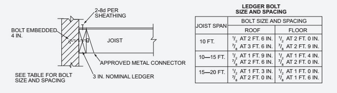

Attachment of Landing to CMU
2021 IRC Section R606.11 Anchorage​
Masonry walls shall be anchored to floor and roof systems in accordance with the details shown in Figure R606.11(1), R606.11(2) or R606.11(3). Footings shall be permitted to be considered as points of lateral support.​
For SI: 1 inch = 25.4 mm, 1 foot = 304.8 mm, 1 pound per square foot = 0.0479 kPa.
Note: Where bolts are located in hollow masonry, the cells in the courses receiving the bolt shall be grouted solid.

Don't forget the footnotes!
True enough...then you have to be concerned about the 300# concentrated...Obviously the snow does not kick in unless it is exterior...
Tables in the IRC incorporate the minimum loading conditions from the IRC, so I am not sure why you have concern...
And if it is exterior, it is not a floor - it is likely a deck, and the applicable requirements for decks would apply.
Because the stair has a specific loading not addressed under floors.....Oddly enough there is no definition of deck in the IRC and decks are floors that's why they are in Ch.5...As this is from Ch.6 I am a little curious if the intent is floor support (although it seems like it is) or wall (lateral) support (per 301.3 #1 or T602.3(5)) and maybe there needs to be a pointer in Ch. 5 if it is for supporting floors.......
