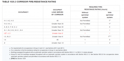

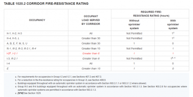

OK this is a massive change or a massive error.

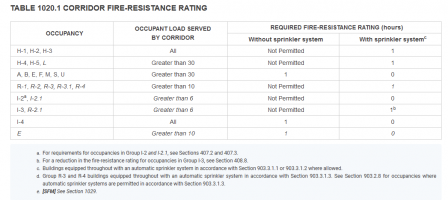

If you look at the 2019 table a B occupancy in a fire sprinklered building was given an exception for fire rated corridors if per footnote "c" the fire sprinkler system complied with 903.3.1.1 or 903.3.1.2. My understanding was that in order to take this exception the building would need to have been constructed after 1996. Buildings constructed before that date the fire sprinkler system would not comply with 903 and the exception could not be taken. This seemed reasonable as there were many changes to the fire sprinkler installation requirements in the 1996 edition of NFPA 13. I have been constantly battling with brokers who insisted that they could remove and derate all rated corridors and install glass doors and glazing throughout just because they were fire sprinklered.
Now I look at the 2022 CBC table 1020.2 and see that the footnote "c" has been removed from the top "with sprinkler system" notation and placed further down the chart at each occupancy. B occupancy now indicates a "0" rating if protected with a sprinkler system.............................. with no caveat regarding compliance with 903!
looking at the IBC 2015, it was consistent with the 2019 CBC chart. 2018 IBC is now consistent with the 2022 CBC as well
Is this a massive change or an error? any vintage fire sprinkler system will now provide a rated corridor exception?
What do you fine people think?

Since they didn't correct it in the 2024 supplemental changes, I would assume it's intentional and not a mistake. Especially since they fixed the footnote errors that the original 2022 code had in this table.
That seems to be true that it is intentional. But there must be a mechanism to preclude owners of very old buildings that have sprinkler systems but were previously constructed with one hour corridors from simply removing the rated corridors or modifying them with glass doors, windows, non rated doors etc. thereby eliminating the one hour corridors due to the fact that they have a fire sprinkler system of any vintage. That is preposterous. Previously the fire sprinkler system needed to be installed after a certain date to allow taking the exception. San Diego jurisdiction it was 1996

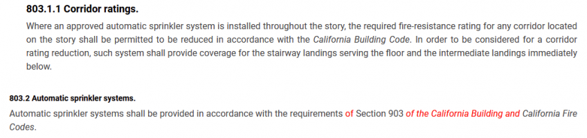

I am not really well versed in the Existing Building Code but there is this. but this seems to address current installations not existing.
Well that's new. I wasn't aware that the SFM adopted ch8 of the CEBC. Up until July 2024, Ch6 - Ch13 weren't applicable to California. I'm a bit surprised we're suddenly changing this.
Regardless, I too am unfamiliar with most of the CEBC, but I agree that 803.2 seems to address new installations instead of existing installations.

Here is an answer to my question by someone much more qualified than myself:
"I have looked into this now, including a review of the 2013 Code requirements and the 2022 Code requirements, and I don’t see where this really changes anything. And here is why I have reached that conclusion.
First, even back in the 2013 Code, the footnote was not a reference to CBC Section 903 in general, but instead a reference that took you to CBC 903.3.1.1 or 903.3.1.2. Those two sections are the requirement to provide a system that is compliant with NFPA 13 or NFPA 13R, respectively. I am not sure why that kind of a reference would be necessary except to clarify that when a building is eligible for an NFPA 13R system, it can be used to justify compliance with the fire sprinkler requirements of CBC Table 1018.1/1020.2.
Then, when you look at the current table, CBC Table 1020.2, the requirement to provide fire sprinkler protection has not gone away when a non-rated corridor is provided, only the footnote that directed you to an NFPA 13 or 13R system has been removed. So if the non-rated corridor option is proposed, the building must still be provided with fire sprinkler protection, and per CBC 903.1, that fire sprinkler protection must be compliant with Section 903, which would include compliance with 903.3.1.1 or 903.3.1.2 or 903.3.1.3, whichever is applicable. What needs to be kept in mind is that both NFPA 13D (903.3.1.3) and 13R (903.3.1.2) have scoping statements that define the types of occupancies and uses where the systems can be used, so the Standards themselves take some of the guesswork out of it. And if you cannot use the 13D or 13R Standards, then you have to use the 13 Standard. And that all brings you back to where we where before they relocated the footnote.
So based on this, I don’t see that anything has really changed, and it would be my conclusion that we will still enforce the same requirements that we have been enforcing."
The I-Codes over the years reduced the fire rated construction requirements if a fire suppression system was installed. This was done so designers would be able to encourage developers to install a suppression system by offsetting the savings on the fire rated assemblies that would be required for their project.
If the existing fire suppression system was not designed to meet 903.3 requirements then it is not an approved system under todays code that can be used for reduced fire rated hourly assemblies or increases in area or stories of buildings.
