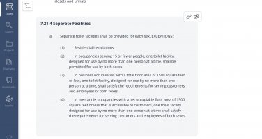

It doesn’t appear you need to calculate occupant load for the toilet count in this situation. New Jersey plumbing code says in mercantile occupancies with less than 1500 square occupiable by customers one toilet room satisfies the requirements.

1 restroom, accessible should do

Accessible, wouldn't want to discriminate, I'd make it meet ADA.

Almost all bathrooms have to be accessible...Especially when there is only one....
1110.2 Toilet and Bathing Facilities
Each toilet room and bathing room shall be accessible. Where a floor level is not required to be connected by an accessible route, the only toilet rooms or bathing rooms provided within the facility shall not be located on the inaccessible floor. Except as provided for in Sections 1110.2.4 and 1110.2.5, at least one of each type of fixture, element, control or dispenser in each accessible toilet room and bathing room shall be accessible.
If you have accessible common area bathrooms in the mall within 300 feet of the suite you could use those bathrooms. If not you need an accessible restroom

Not sure why the OP replied that they would be ok moving forward with a non-accessible bathroom, as all have indicated otherwise.
A fully accessible restroom would be required if it were a new building. This sounds like a minor renovation, so the most they might be required to do is spend 20% on upgrading accessibility.
