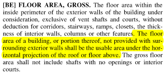

I've seen plan checkers claim that the area of the recess is technically floor area under the definition in IBC 202:
Certainly those punched openings could not be used for egress (or bedroom emergency escape windows) if the're no walking path at ground level along the property line. You could ask your neighbor for a no-build + egress easement on their property, but they'd have to be in a generous mood.
