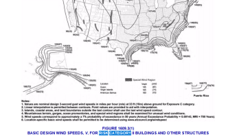

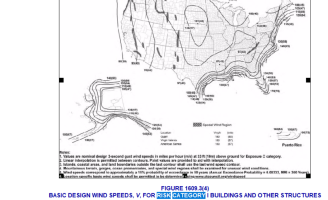

If it designed for the conditions where you are it should be fine....If they are calling it a U then they might be calling it Risk I and that would be no bueno....
Type U is an IBC classification and a Risk Category I designation for design purposes which are not intended for human occupancy
In your state and what part of the state it would be a significant reduction in the wind loading requirement used in the design of the structure.
