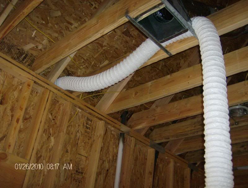

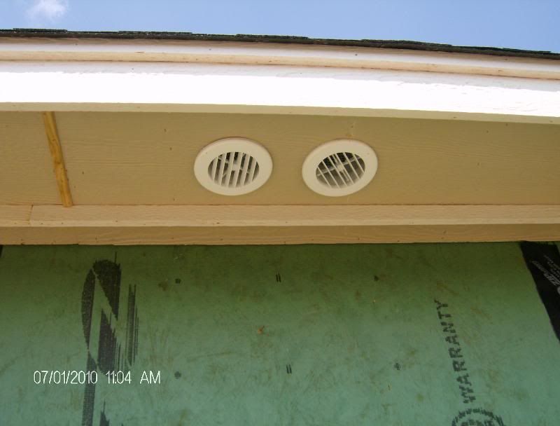

Well it looks like they have found a way to terminate the bathroom exhaust vents "directly to the outside" through the soffit overhang;
(right click on picture to enlarge)
and,
Here is a single. But they still don't understand that the duct material has to be listed for consealed location;
This type duct is not listed for consealed location.

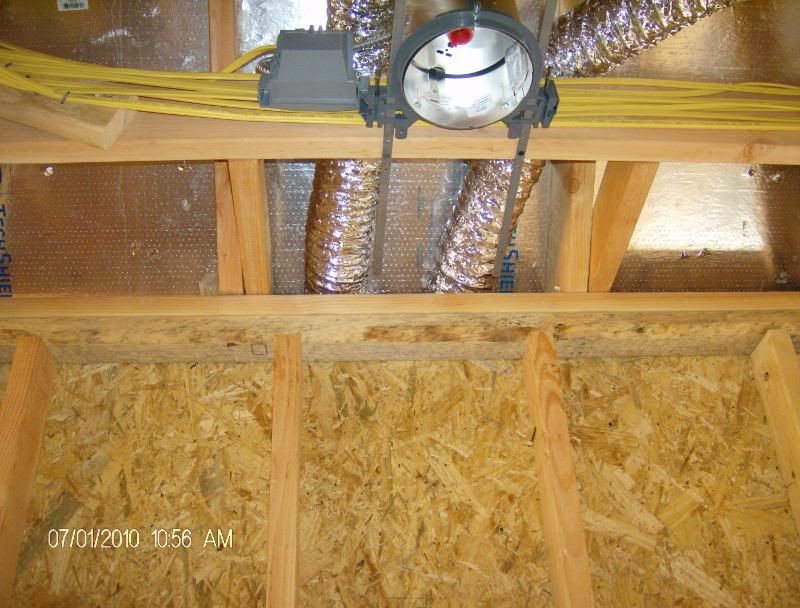

Here is another bathroom exhaust duct that is not listed for consealed use;
This one was terminated into the soffit (not directly to outside the building).

For soffit terminations, I have seen rectangular shaped caps complete with backdraft dampers. The assembly protrudes down from the soffit about 1 1/2". They seem to work well.
Why would you vent moisture laden vapor into a vented soffit where it can enter back into the attic? If it's not a vented soffit, how are they ventilating the attic?

Confused here. Sooo, the pvc and metallic flexible duct shown in the pictures are not approved for bathroom exhaust?
Greg,
" Sooo, the pvc and metallic flexible duct shown in the pictures are not approved for bathroom exhaust? "
Correct; not listed for use in consealed location. But, unfortunately, most jurisdictions allow them anyway.

Some flex ductwork is LAL for concealed locations at any length. Flexible dryer connectors cannot be concealed but there are lots of products that can be used for bath exhaust, hvac supply air etc. and can be concealed. Some can be concealed but have a max. 14' run. It all depends on the LAL of the product.
Most bath fans also have a damper built in so you don't need the damper at the termination cap. We allow fans to terminate in the soffit if they terminate in an approved cap. Not a good idea but the code does not prohibit it.

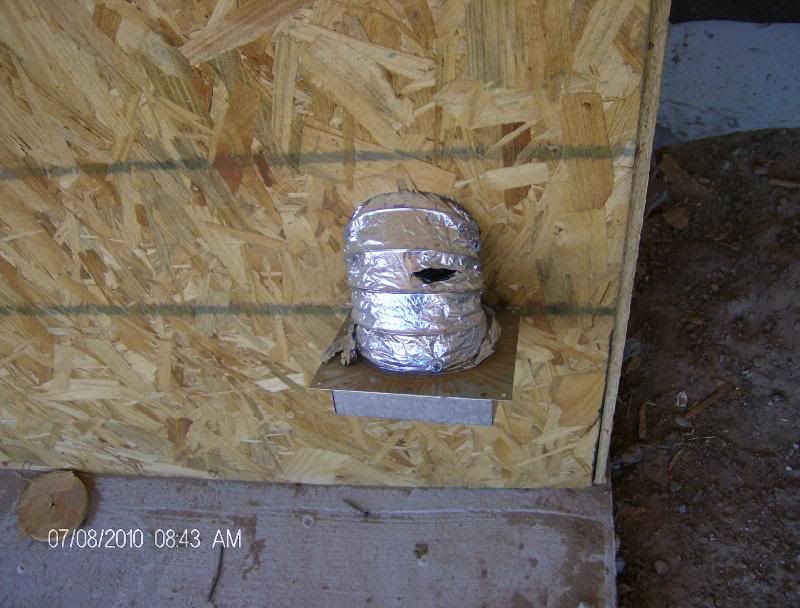

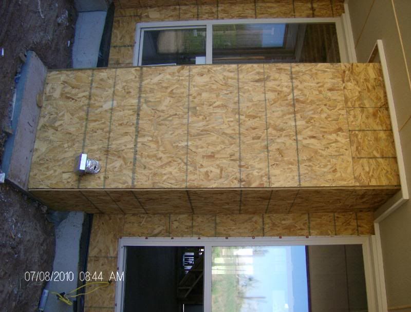

Here are some pictures I took Sunday in Moore, Oklahoma.
The first is a combustion air duct for a factory made fireplace; note the hole that will be consealed when the termination cap is secured;
and,

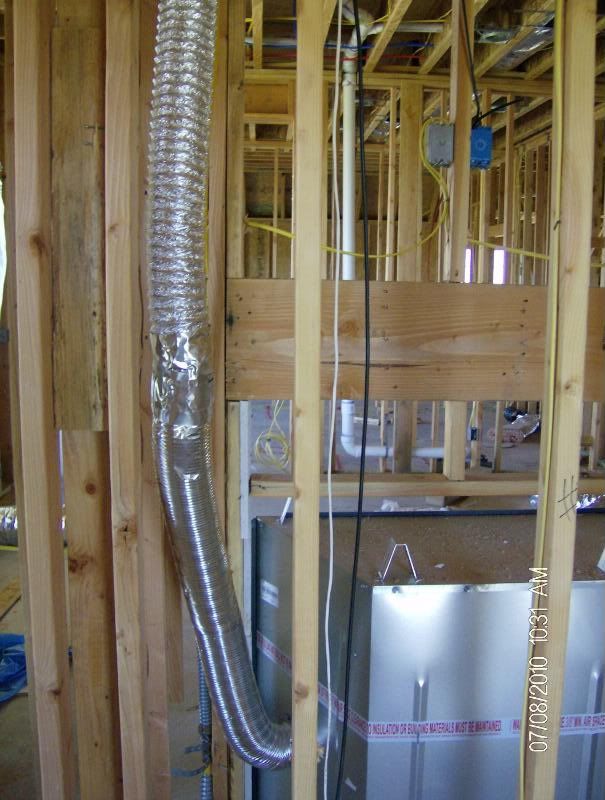

Here is one that was started from the fireplace with semi-ridged and then they used tape only to secure it to flexible aluminum. The tape is affected by temperature changes and will fall off; causing the lower duct to fall away from the the upper one. I've seen this many times before the BO stopped allowing the use of tape only (requiring screws to secure the joint (on combustion air only);
