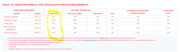

Stationary storage battery systems shall be regulated and ventilated in accordance with Section 1207.6.1 of the International Fire Code and the general requirements of this chapter.
[F]​
Stationary storage battery systems installed in cabinets shall be provided with ventilation in accordance with Section 502.4.
Steveray -- That table is for ESS systems. I don't think it applies to batteries in fork lifts and similar mobile equipment.

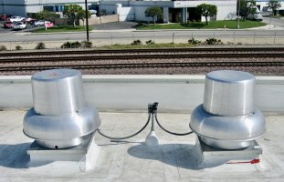

I had a 400,000 square foot warehouse that obtained a permit for a "Hydrogen collection system". There was a wall lined with about 20 forklift chargers. The plan called for a draft curtain that hung down eight feet outlining an area over the charging operation. The ceiling was 42 feet above the floor. There was two sets of two roof top fans that were interlocked with the chargers. (picture provided) The reason for four fans was that one at each set would operate and if either failed to operate, the other fans were backup.
Having never experienced a hydrogen collection system before then, I was ever so curious about explosion proof that and detonation proof this. Clearly, those fans are not that. Such was also the case with the conduit banks, disconnects and anything else electrical that could make a spark.
I researched the hydrogen issue and the battery makers stated that there is a negligible release of hydrogen at the end of a charging cycle. Given that a defined LFL would not be possible in a warehouse with the volume as what I was dealing with, a different path was chosen.
The company was attempting this because an insurance company required it.
