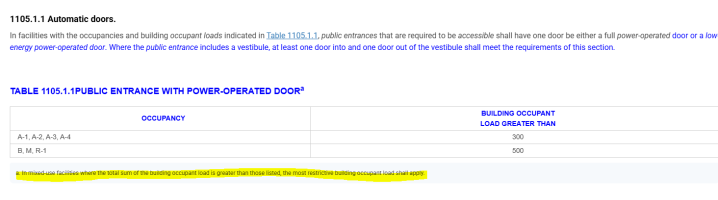

If I have a school building that includes an A assembly occupancy (auditorium, cafeteria, gym), do I need to provide at least one of the entrances with an automatic door opener? It seems to have conflict with the safety lockdown system.
What do you guys think?

No, the building code does not require the use of automatic doors:
A117.1-2017 Commentary on 404.3.1 Public Entrances (partial quote)
At the writing of this commentary, the International Building Code does not require automatic doors at any location.

New York State is under A117.1-2009. Doors are addressed by 404.2, which limits to force needed to open doors but does not require automatic doors. 404.3 addresses the parameters for automatic doors, but does not require them. Nothing in IBC Chapter 11 as adopted by the State of New York requires automatic doors.

Yes...it does
Isn’t that something. I see that the 2018 IBC doesn’t have that provision, so looks like the A117.-2017 commentary is out of date, thank you for citing the new IBC reference.

School is not a mixed-use facility but an E occupancy building. that's why I have a little doubt if this should extend to the room/space level or it's the facilities occupancy group.

per IBC 303.1.3, room or space used for assembly purposes that is associated with a Group E occupancy is not considered a separate occupancy.
I guess I don't need to provide an automatic door opener for my school building. agree?
