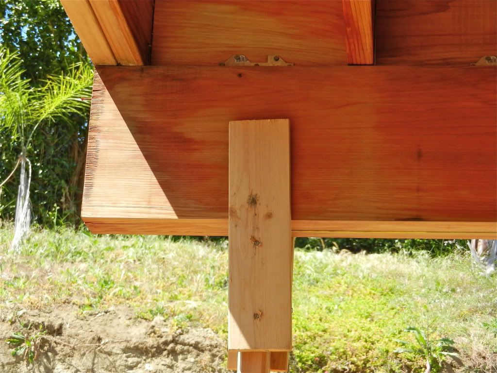

one side
the other and no, that dark spot is not a nail head.

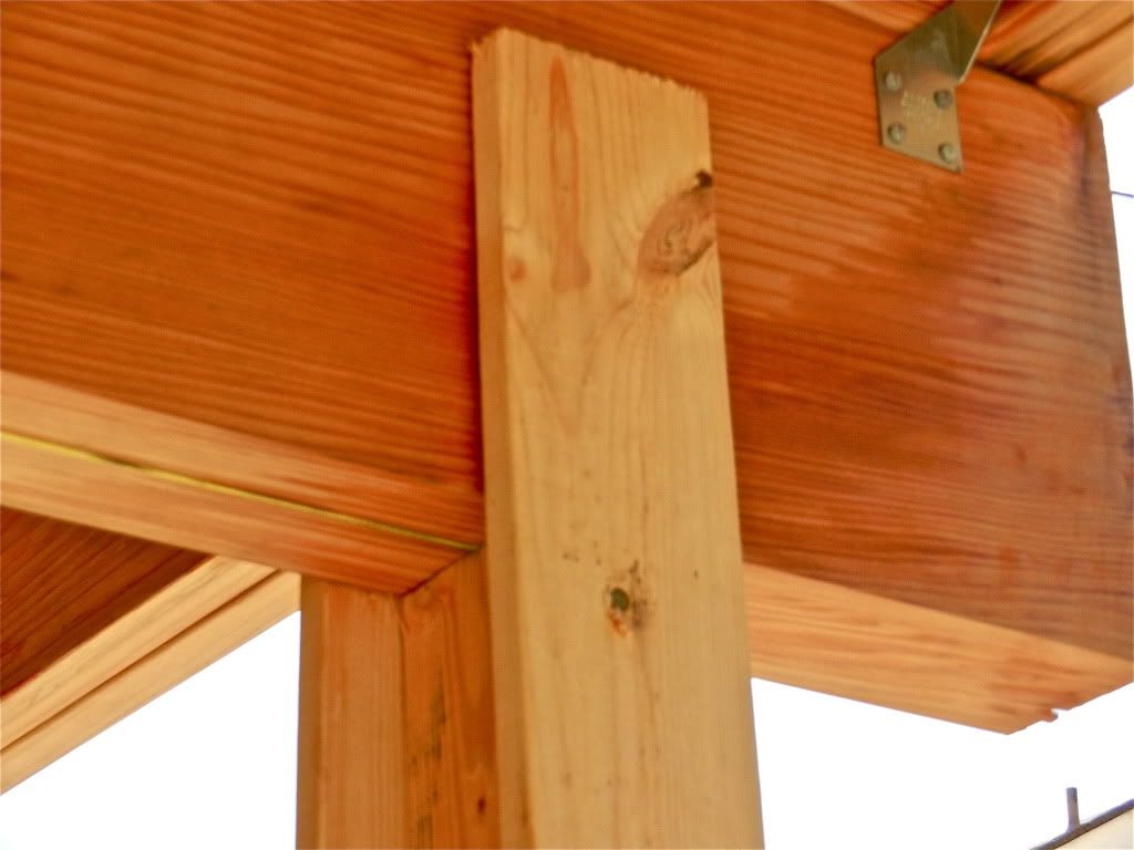

There is no lateral support for the bottom of the girder. This could result in a failure. Would suggest bracing bottom of beam up to the deck joists.
The column also looks like it is a 2x. Suggest column size is inadequate.
Yeah, I think the the 2-2x10 girder may be a little overspanned, too.
Not a big fan of balusters installed that way.. but I can see it is a low budget project.

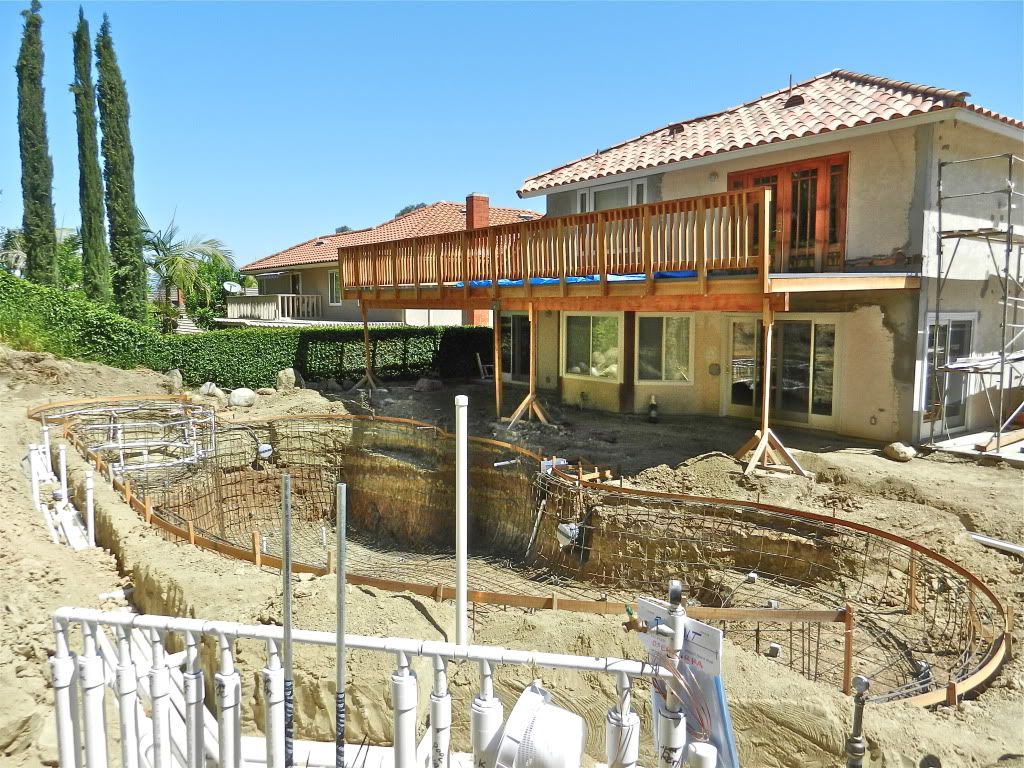

Do not see enough detail to say for shure but I do not see how the railing on the deck can resist the required horizontal loads.
All the columns appear to be temporary 2x4s except perhaps the center.
Question; do you require engineer acceptance for the pools at the foot of this ascending slope or do you have a standard for your area?
Francis Vineyard said:
All the columns appear to be temporary 2x4s except perhaps the center.Question; do you require engineer acceptance for the pools at the foot of this ascending slope or do you have a standard for your area?
We do have standard pool plans and they include a design for a surcharge and the contractor built to that design. This particular situation fell outside the parameters outlined in the standard surcharge plan so the contractor then had to hire a separate engineer to re-engineer the pool wall. The engineer added #5 bars. I forget the exact layout but the steel was 4" oc. with #4 & #5 mixed. The wall and floor thickness went way up as well.

The center post is hanging off the beam.

Low budget? I bet they are spending $85k on this back yard. There are two 60' long retaining walls behind the pool. One wall is 3' high and the other is 14'.
NH09 said:
Are those joists 2x6 ?
No. I can't tell from the picture but I think they are 2"x10". I haven't gotten to inspecting the deck. They didn't have a permit for the deck.

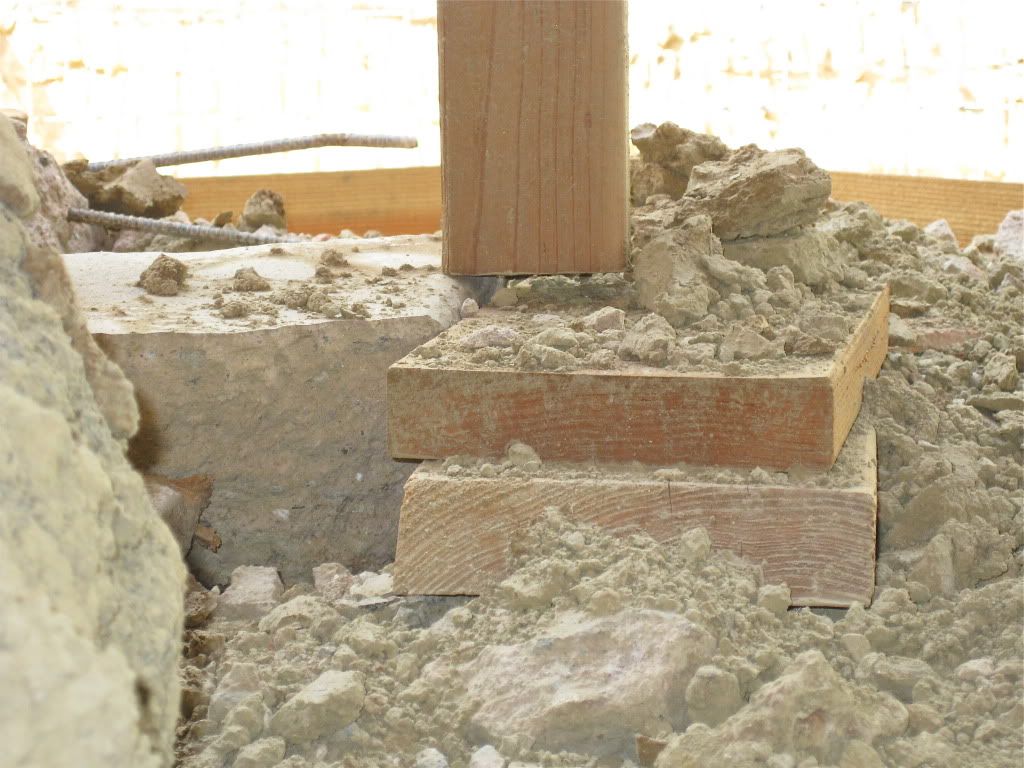

Question for thought.
Could the center post footing loads be a negative impact on the sidewall of the pool. I am of the understanding a footing will excert loads at a 45 degree angle away from the bottom and be spread over the supporting soils.
mtlogcabin said:
Question for thought.Could the center post footing loads be a negative impact on the sidewall of the pool. I am of the understanding a footing will excert loads at a 45 degree angle away from the bottom and be spread over the supporting soils.
The footings are not dug in these pictures. They have them now and they are as deep as the pool. You are correct about the 45 degree angle.

So far nobody has mentioned that the temporary support cleats are not nailed to the beam. The support posts are 2"x4". If a workman fell into one, the whole mess could come down.
TimNY "Yeah, I think the the 2-2x10 girder may be a little overspanned, too."
My first instinct was a double 2x girder as well. I just couldn't figure out why in the second picture it looks like there are 2 members coming from left to right but to the right of the support there seems to only be one. Look at the bottom of the beam to the left of the support and compare it to the right of the support. No separation of the 2 plys on the right side, continuous grain. Then it hit me like a ton of bricks. The apparent separation of the 2 members is nothing more than a string!
