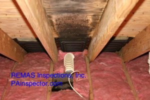

I often see zero air-sealing where the plenum exits into the attic through the ceiling, and I rarely see the supply resisters properly air-sealed to the floor of the attic. Unsealed flues and AC line-sets are also contributing to failures, in addition to bath-fans, walk-up attic stairs without thermal covers installed, poorly constructed attic hatches, plumbing/HVAC chases from the attic that lead all the way to the basement, and electrical penetrations left unsealed or sealed from the interior of the home not the attic-side.

In my experience, the source of leakage that is most commonly overlooked is through interior walls and openings in the ceiling, i.e., fixtures and smoke alarms. Interior walls are full of switches an outlets. Air also leaks through the base of the walls. From here it simply passes between the top plates and drywall through the insulation and into the attic. Builders around here foam or caulk these areas and have little trouble passing the 3.0 BDT.
