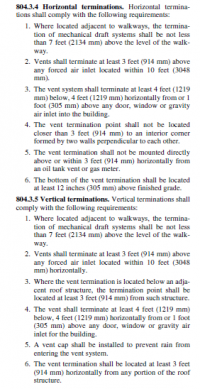

2012 codes - I'm not sure if this is an IMC or IFGC issue (or maybe both?). What section specifies distance from roof edge/parapets or property lines for boiler flues?

From the `12 IMC, Section 804:
Here's a Link to the IMC:
http://codes.iccsafe.org/app/book/content/PDF/2012%20International%20Codes/IMC/Chapter%208-Chimneys%20and%20Vents.pdf
My Snippet Tool could only capture the Code Section in this size.
Sorry I'm late getting back to this conversation. I took the weekend off for once. :)
So does Section 501.3.1 apply here also? Or does that only apply if there is a powered exhaust fan on the roof? :confused: I was trying to determine if the boiler flues need to be 10 feet from the property line or if they are ok just being 4 feet from the parapets.
cballinger,
IMO, ...Yes, Section 501.3.1 [ from the `12 IMC ] DOES apply.
Also, ...this particular code section requires a minimum of 30
feet distance from a property line.

That seems excessive. I would typically apply that to hazardous exhaust systems, which are usually in buildings with a setback anyway. So you can never have a boiler system in a building on a narrow lot?
Section 501.3.1 DOES state " or flammable vapors,
fumes or dust".
