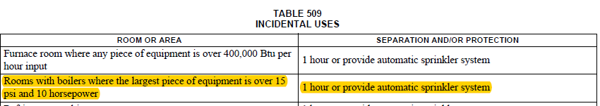

I am trying to locate the code regarding fire rated doors for a boiler room. The boiler room is in the basement and the basement is being finished. I am getting different answers from different people. This is in a single family residence in upstate NY.
I would love to know where to find this info in the code. Can anyone help?
