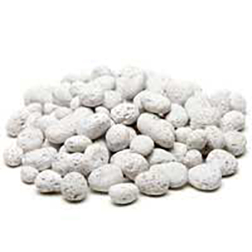

Or would be expected to catch: three inches of regular-weight concrete instead of two inches of lightweight concrete,
There is a difference in color, with the lightweight being darker and the reveal at the bottom plate would be -0"-. That's not to say that it would be caught by the inspector.

An aside, why is the 3" of normal weight a deficiency?
"Lightweight concrete presents a number of benefits to the building industry–lighter weight on a building’s structural load, greater sound absorption, better shock absorption and flexibility, improved insulation values–when compared to standard concrete blends. However, it has also been suspected in increasing cases of moisture-related flooring failures. Knowing the advantages and disadvantages of lightweight concrete can be the foundation for making better choices at the design and installation stages."
If a suspended slab, I get it, but if slab on ground, doesnt seem significant. Does a 2" lightweight insulate better than 3" normal weight?
My experience was roof decks on theatres for isolation fromexterior noise. At the end of the day, most experts only cared about pounds per sf, not thickness or density. Form deck under, insulation and membrane roof on top - just psf please. (Which could be a lot if near helicopter traffic!)
In the article it indicates that the original plan was slab-on-grade; however, the subsequent change included a crawlspace. Therefore, it is presumable that the performance of the floor system would be jeopardized given that the concrete floor is around double the weight of what it was likely designed for.

Light weight concrete is usually on the second floor as it helps with sound control. It is not common with SFDs.
If that's the case, I get it, but seems like a convoluted path, and not an easy fix if the floor framing is overloaded.
It is a convoluted situation presented in the article. Sounds like multiple levels of ineptitude and general unawareness from the project team. And correct; by using concrete that is likely double the weight designed for, the engineering fix is likely to be complicated. May perhaps be easier to demo the concrete out and go with the proper material called out in the design.
We see it from time to time in a SFD, usually because they are installing radiant heat in the home.
Same mtlogcabin. Although, given we do not have a good source of lightweight aggregate in my area, it is more common to see gypcrete.
