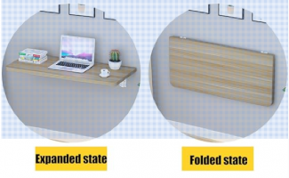

Yes, instead of breadboards, I've seen a 30" wide fold-down table provided on a blank wall elsewhere in the kitchen. This meets the definition of countertop "work surface".
