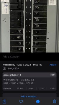

These bolted locks were put on the breaker handles after I did the final inspection and they got the C. O. They keep anyone from turning off the breakers but do not keep the breakers from tripping. The fire company asked me about them on their inspection. I don't think they are allowed by the NEC. Has anyone else seen these?
I have not encountered those. What circuits are involved? Are they multi-wire branch circuits? Do they prevent the breaker from being reset after a trip?
Unless they prevent the breakers from tripping I don't see anything wrong with them even if you can't reset a tripped breaker without removing them. You have any manufacturers information on them?
There is no NEC requirement that forbids locking a breaker open or closed, as long as it will still trip.
A similar question that comes up occasionally is whether someone can put a padlock on the exterior service disconnect for the building to avoid people shutting off power to the building as a prank. The answer is that you are absolutely allowed to lock it, and if the firefighters need to shut off the power, they have all manner of tools to get that lock off quickly at their disposal.
Side note, I have had electricians attempt to use those same cute little devices as the provided means to make a disconnect lockable because it was out of sight for the equipment served. I shot them down on that because I do not think they comply with 110.25. There is no definition of "lock" or "lockable" in the NEC, but one of the definitions from Merriam-Webster is "a fastening (as for a door) operated by a key or a combination". I do not think a Philips screw complies in an objective sense, and it definitely does not meet intent - the lockable device is provided for lock-out tag-out purposes.

Sure, you can do it manually, just pull out your screwdriver and remove the little lock. Think of it more as a reminder to the user that "this circuit is special--do you really want to shut it off?" Same idea as those little plastic devices for toggle switches, shown below.

I don't think circuit breakers as branch circuit disconnects are intended for emergency shut-off purposes, they are intended for servicing equipment. Emergency disconnects are specified elsewhere for other items with specific language that is not found regarding branch circuits in general. If you are servicing the equipment, you pretty much have to have a screwdriver, and those blockers would not pose any difficulty.
I think folks do this for circuits serving security systems or computer systems they don't want to accidentally get shut off.
i don't see anything about locking a spa emergency switch in the NEC. So does that mean it's ok to lock it closed too?
Just the use of the term "emergency" switch in the NEC suggests by itself that it should not be locked closed. Since it needs to be operable in an emergency.
And that further suggests that other disconnect switches not called emergency switches in the NEC are not intended for emergency use, and that no such prohibition would apply.
No NEC violation in the photo in the OP.

That's true. To fail the installation in the OP, you should find an NEC section that says this disconnect shall not be locked closed. Or shall be operable without tools. Or something like that.
I think your best bet would be 240.24(A) which says ". . . circuit breakers shall be readily accessible . . ." Along with the definition of readily accessible, which starts off "Capable of being reached quickly for operation, renewal, or inspections without requiring those to whom ready access is requisite to take actions such as to use tools (other than keys) . . ."
Now you have to decide whether that definition means you just need to be able to reach the circuit breaker without using tools, or whether it is implicit that you should be able to "operate, renew, or inspect" the circuit breaker without using tools. I would favor the former interpretation, as the latter would, for example, seem to preclude using screws to hold on the panel dead front, which you need to remove in order to inspect the circuit breaker.
Cheers, Wayne
I think don't think there is a prohibition to locking the whole panel, at least in your home, so why would locking a single breaker matter?
If it's not allowed, ironic the there are UL listed devices to permit locking breaker on or closed.

Pretty much doesn't matter, they don't stop the safety of the breaker tripping and they prevent the power being turned off by accident.
If the FD is worried, tell them to request a string or small chain with a screwdriver attached and someplace visible for easy reach and use.

Nothing in the codes prohibits their use. UL 489 is the listing. They have nothing to do with " readily accessible.
