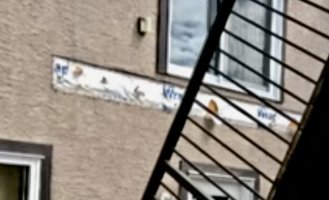

What I find interesting is that after this deck collapse, the building told all of the other homeowners not to use their deck, then proceeded to fix all of the decks, had the balls to say the collapse was not their fault. Really? They then drag their sub and the city into the lawsuit.
In this case, the city reached a settlement agreement with the builder.
In my opinion:
1) The builder has a responsibility to check the work of their subs. This is their supervisory responsibility.
2) The sub-contractor obviously screwed up.
3) The city clearly dropped the ball and whatever inspectors signed off on this were and probably are incompetent.
When you say "builder" do you infer that to be the developer or the general contractor? The developer should not be held responsible whereas a general contractor should be held responsible. The city is in Canada and if I recall correctly, the Canadian members have said that there is no qualified immunity granted to Canadian building departments.
Missing lag bolts is reason enough to fire the inspector. I am curious to know what the plans specified. Beyond the decks is a house... a house that was presumably inspected by the same crew that handled the decks. That would bother me.
It is noteworthy that the guard rails are not secured to the building.
It is difficult to be sure from the video, but is there flashing that would have been above the ledger?

It's the lag bolts at deck ledgers. What could be more obvious than missing lag bolts at deck ledgers? I can't get over the fact that nobody noticed the missing lag bolts.. There should have been HD's with all-thread but "should have" don't count.
